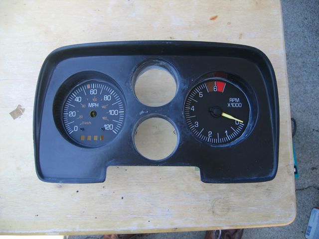

I finally had some time to work on this project again. I was working on upholstering the dash today and while I waited for the contact cement to dry, I would work on the instrument cluster. I cut out the tachometer and speedometer and loosely placed the stock Fiero gauges behind it. I still have a lot of sanding and finishing to go, but I am not convinced that this will work.

I used Fiero gauges with overlays and modified needles from a fiat 124. I just rotated my tach clockwise a liitle so it looked right when I mounted it to the pod. you can see the trip reset button under the speedo
