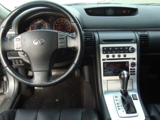

    the beautiful 2005 g35 auto i chose. yup, looks a little effed up. i do like the 2005 gauges though and there is lots that can be done to make them not look like a g35 anymore. i decided on an auto since i will be going straight into an all alum 5.3-6.0l ls swap with the 6l80 or 6l90 gm 6 spd auto. these trans can be built to hold up to 1400hp in drag racing condtions, fully user programmable, and can hook up full push button control and paddle shift. i think it will be a great choice for what i am looking for out of the car. they are also nearly the same dimensions as the th400, which has already been proven to work in the 350z/g35 trans tunnel.

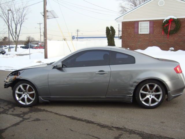

    pics of donor- (yes, it will need a few suspension pieces replaced)
    it is not confirmed if it won or lost the battle with the cyclone fence it went under, but it atleast looks like there was casualties on each side!!
    luckily the donor only has 85k miles, so if i do drive on it for a little while atleast i know it is still in good condition. these are very well built motors and won alot of awards back in early 2000's for their engineering.
    matt confirms it started right up and no weird sounds.
