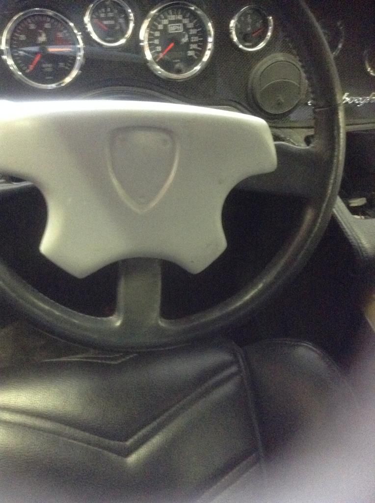

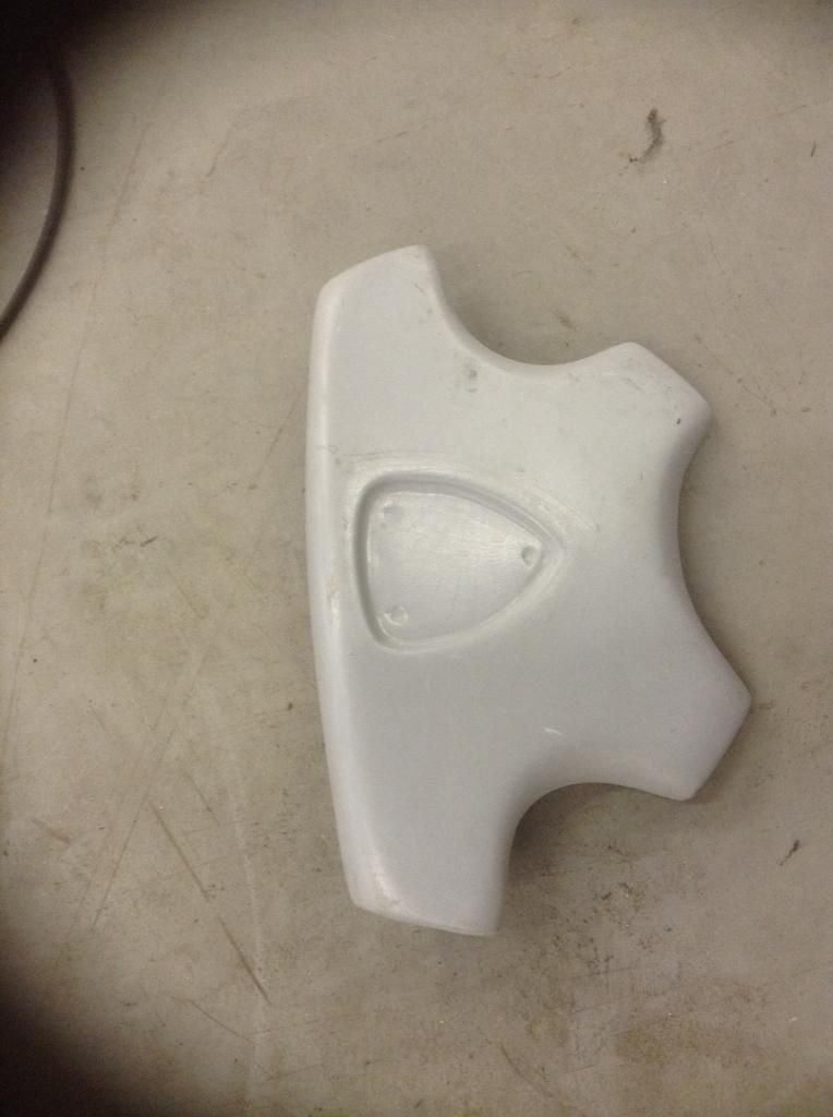

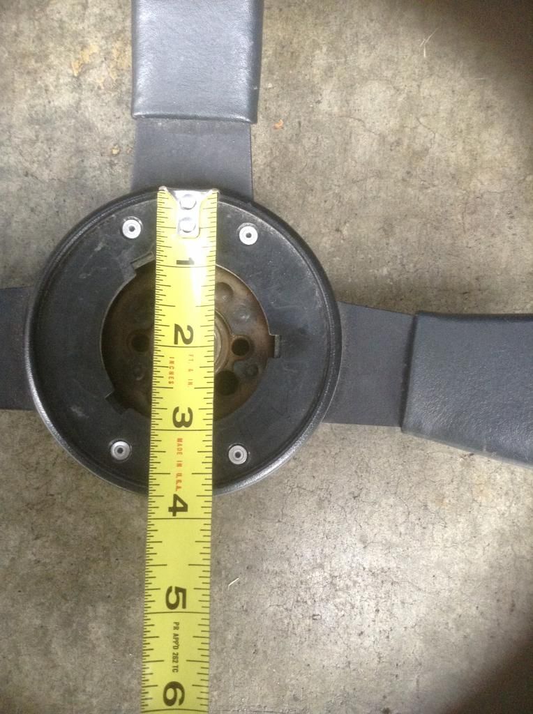

    Hi all builders how does this steering wheel thing work? I have the cover part but what type of wheel do i need to buy to make it complete? I have only the plastic center fiberglass part with the old fiero wheel which does not fit in as seen in the pics. I do have a column for this. does anyone know where or what kind of steering wheel I need to make this work? Also will I need a adapter? Does this center fiberglass piece have a backing part? Am I missing a second piece of backing fiberglass?
    pics of my old fiero steering wheel that does not fit this 98 diablo roadster replica fiberglass center part. you can see that the spokes are way off in the center fiberglass piece.

      That center air bag cover was designed to fit a Grant steering wheel. I think it is this one.

        Thanks jim! I'm still confused about the backing. I know the front will be the airbag of the steering wheel cover. But does the back need something to snap in or hold it? Or is it just the column in the back? I'm not sure if there's something I'm missing to complete the set up. So far I can buy the wheel, I have the front fiberglass airbag cover part, the column and I can buy a adapter if I need it.
          Yes, there is a backing piece that goes with that cover.
