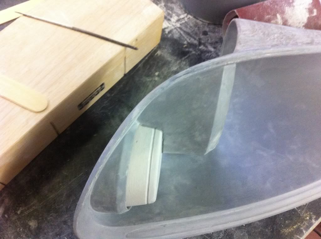

    Been working on the indicator lights for my 430 build...see pictures below..

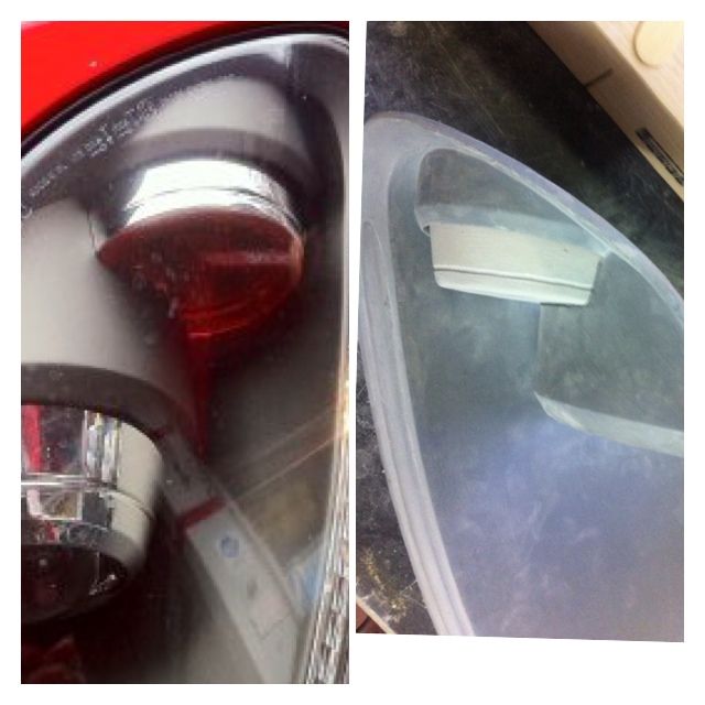

          Well... I ended up redoing them as the shape wasnt correct!! Friend of mine has oem headlights so i had the chance to check them out, so that is how i have found out...
          Below i describe the process:
          I found out that a can of cat food has the perfect diameter/shape... Only about 5 mil. Difference...
          Sanded the can... The applyed bodyfiller...then sanded into shape...then I carved the line using a lollipop mill...the lense that i will be using comes from a 2005 volvo s40... It fits perfectly!!
          Next step was to paint it black ( because i use white gel coat for the mold and black gel coat for the final product because i have to paint it silver) then applyed a clearcoat for a nice, shinny finish...
          Then i made the mold bracket...
          Then it was time to lay up glass...
          Now they have EXACTLY the same size as oem...heheh
          Next up is the wires and bulb fitting etc..

              This is the first mold I have made in my life! Hope it turns out well!!
                Time to mold the other side!
                Adding a feminine touch to it!!!!
                Mold done!!!
                Finished product is following soon!!
                Cheers!!
                  Front piece of the first one 90% done.. Only gotta trim off the marked area and close that with a plate.(like oem).. So it doesnt get in the way of the Bi-xenon unit...
                    Back end com'n soon!! Who would've guessed cat food comes in handy!! Lol
                      Did you finish them? Please post a picture? How much for 2? Thanks
                        Hi they are finished... You have to pot in a lens yourself... It is best for you to make the back end yourself becaus it will depend on the donor headlight you are using.
                        Below is a picture of mine. I used the indicator lens out of a volvo s40 2005 headlight..
